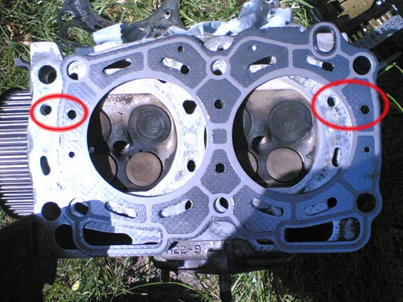

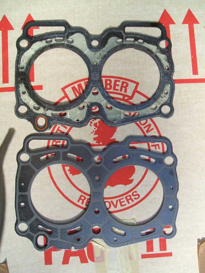

PostPosted: Sat Apr 21, 2007 5:27 pm    Post subject: Houston, I have a problem Reply with quote
The gaskets I got are wrong, can someone please identify what I have! (It's meant to be a 97-98 2l NA Impreza)
Here's my head:
Here's a shot of my old gasket and the supplied one (they're working on it BTW)
You can see I have 3 holes at the top & another 3 at the bottom of my head on both cylinders.
BTW it was the RHS (looking into engine bay) that had gone:
(Edit) It actually looks like the metal bit kinked & slipped during installation!
Also my bore's 91mm, stroke is approx 74mm so the total swept volume is IRO 1925cc - so it is a 2l.

PostPosted: Sat Apr 21, 2007 6:01 pm    Post subject: Reply with quote
The new gaskets look like they clear the water jacket ports fine so the new one should be ok to use, Can;t really tell without actually putting them on the head and checking all holes are fine, it doesn't matter whether they are 3 small or one big hole in the scheme of things.
PostPosted: Sat Apr 21, 2007 6:03 pm    Post subject: Reply with quote
The new ones have holes in totally the wrong place and block some of my holes. Sad
