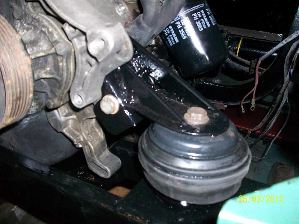

Engine mounts, both manufactured from original Golf mounts.
