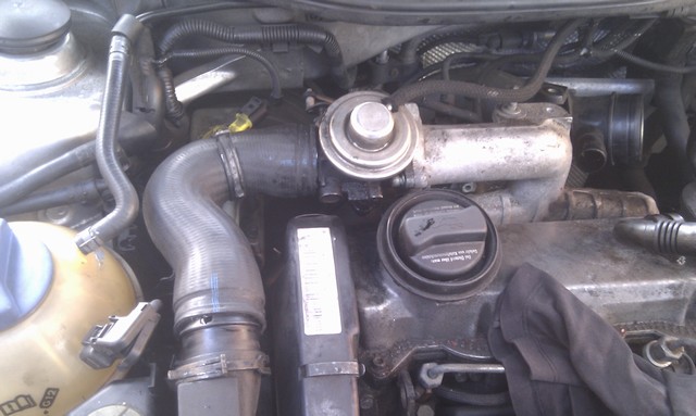

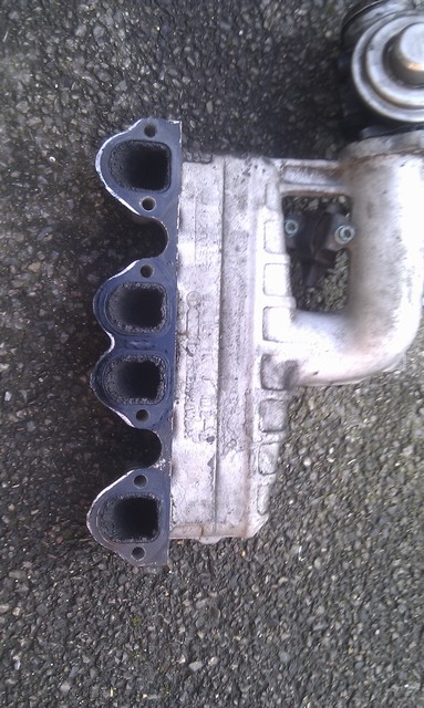

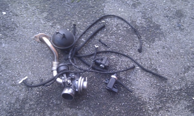

Ok Started to have a play starting with getting rid of all this rubbish (this is not required for the Twin Tank install but did clear some space and make the car go better. I have been informed the EGr removal is an MOT fail however the car hasn't failed an MOT on it yet and is still going.
for the bin..

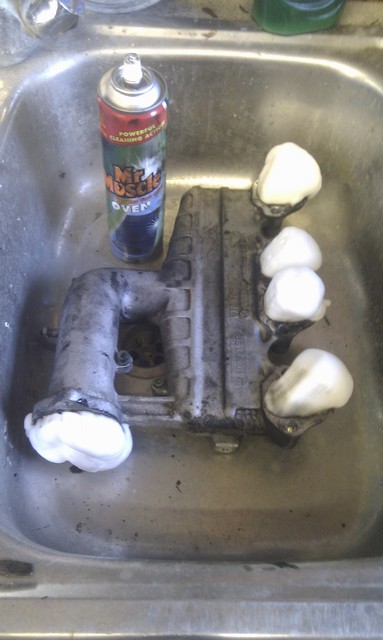

Inlet wasn't too bad
but gave it a good Mr Muscle so nice and clean inside..
[hr]

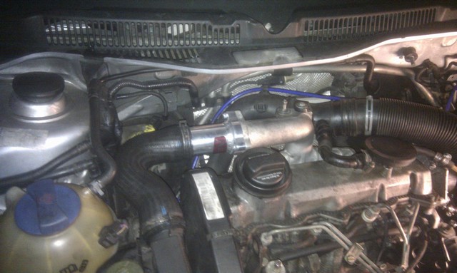

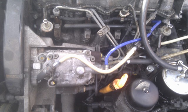

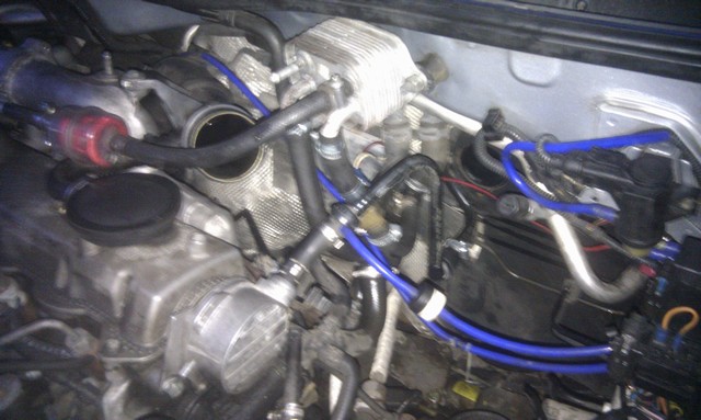

I used an Allard kit which was very nice..
and replaced hoses with some blue silicon ones

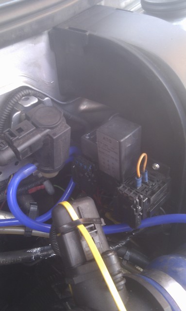

With all the EGR pipes and valves gone I inverted the N75 valve to make some space for the Heat Exchanger.. this wil attach to the bobbins you can see I've attached to the Bulkhead.

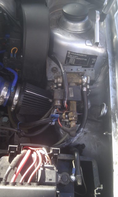

With the airbox out the way I have room for the Solenoids which control the flushing of the engine with Diesel at the end of a run so you don't leave Veg Oil in the engine/pump making it a nightmare to start the next day (think sucking golf ball through hose pipe)

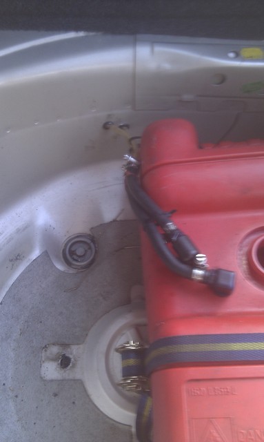

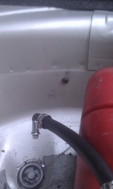

Slow work with this crap weather but managed to fit my boat tank in the wheel well last night. This tank will contain Diesel and used to flush the engine of the chip fat at the end of the day and startup until the engine gets warm enough to heat the chipfat using the heat exchanger which is tapped into the heater matrix feed.

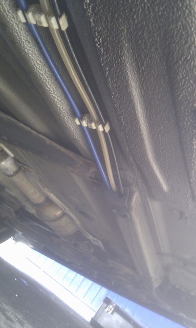

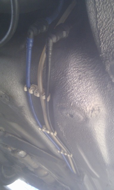

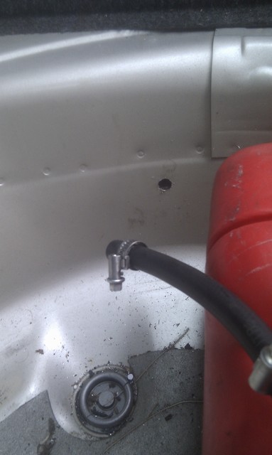

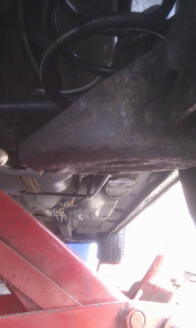

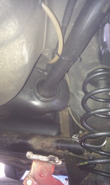

Bit more progress...
Drill hole
Insert Rubber Grommit
Pass Pipe Through
Out the other side
and off to the front of the front of the car cable tying as we go

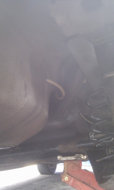

Fits nicely beside the main fuel tank
VW left a space for an extra pipe which clips in nicely
Then shove it in the middle hole
and out it pops next to the main fuel line and return perfect

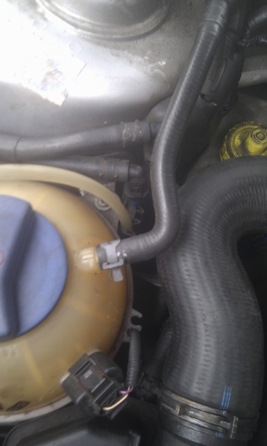

Next Stop Plumbing in the Heat Exchanger to the Heater Matrix..

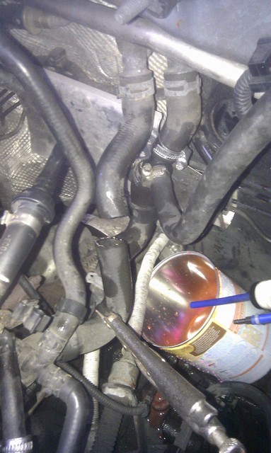

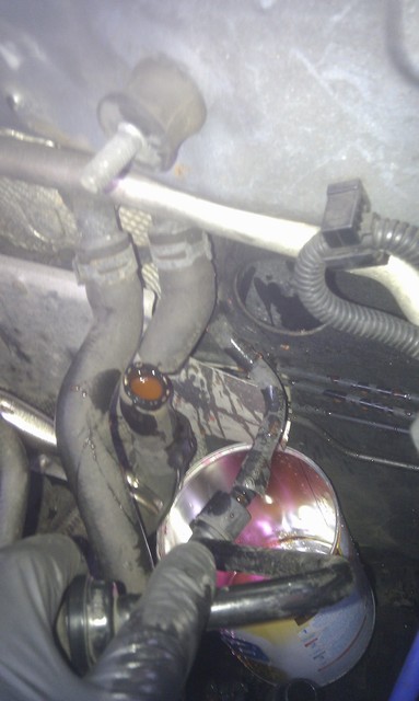

First Cut Pipe which goes from the engine to the heater matrix and take a small chunk out to allow room for T-Piece
Inset T-Piece and J-clip it up then cut the other heater pipe
Insert T-Piece and J-Clip that one up.
Connect pipes from T-Piece's into heater matrix with an in-line temp sensor fitted to one of the pipes that will trigger the solenoid to let the Veg Oil into the engine once the coolant in the heater matrix hits 40degrees.
The Heat Exchanger is fitted in parallel to the heater matrix rather then in-line so as not to cause a bottleneck and keep a good flow to the heater matrix.

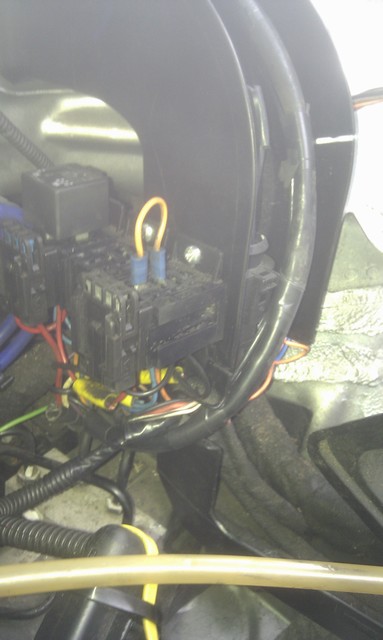

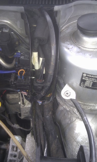

Next up Electrics this basically involves some relays which control the solenoids linked to a control unit which is inside the car.
I decided to attach the relays to the trunking for the main loom
Then pass the loom up through the trunk around the pollen filter into the cabin.
There were also a couple of wires for Perm Live and Negative which went up the trunking to the battery.
then cover it all up
Really happy with the electrics as wires were hidden away nicely and relays tucked nicely out the way.

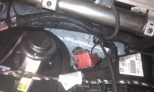

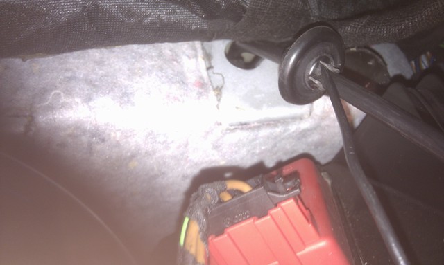

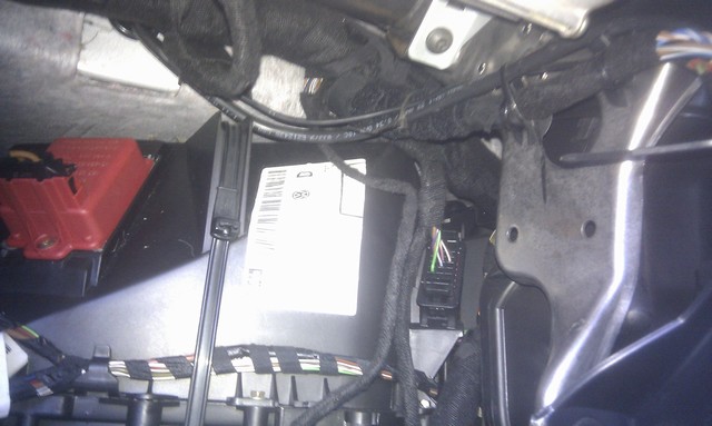

I removed the glovebox and behind there was a nice grommit which goes through to the engine bay (thank to members here for that one). I threaded a stiff piece of wire through the hole and attached the Dieselveg loom to it with tape and pulled it into the cabin.
I then cable tied the dieselveg loom to the stereo loom and thread the cables through to the drivers side.
[hr]

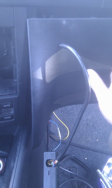

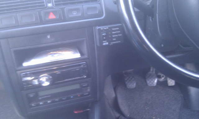

Next I removed the panel to the left of the steering wheel which is where I decided to put the control unit. Iniitally I planed to put it in the same place I had it on my Passat here
Annoyingly when I did this it it rendered the wonderful cup holders useless as it got in the way grrrrr
So remove panel drill hole for deiselveg loom
Screw control unit from behind
Control Unit wired and in place.
There was also a wire that needed a ignition feed for the control box... now this may sound simple but I found that 99% of the ignition feeds seem to drop there voltages to zero when the starter is spinning! This is no good as it takes the power from the solenoids and closes up the diesel ways so to speak. In the end I found a black wire coming out the back of the fuse box that was ignition live and still live when spinning the car over so spliced into this wire.
Wiring done... just the diesel/veg pipes to do.
Ok First job with the pipe work before I forgot was to put a breather in the diesel flush tank in the spare wheel well to stop it imploding.

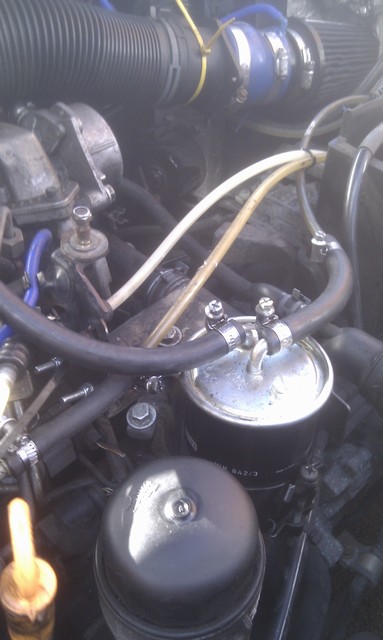

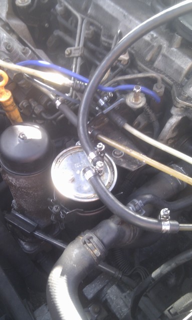

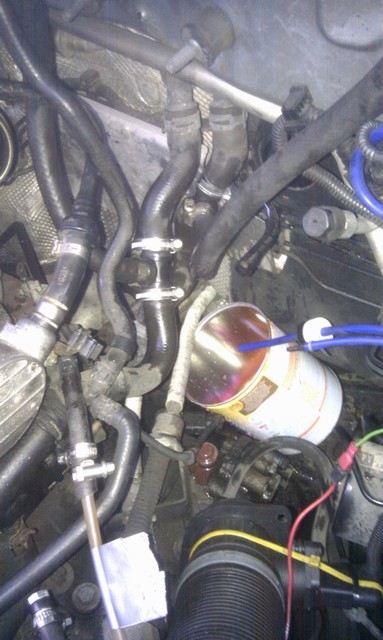

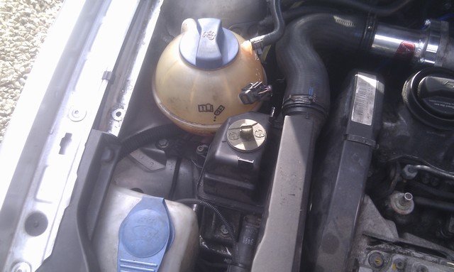

Next up was to move the diesel filter as with it being by the screen washer bottle on the RH side of the engine bay it was a long way from the heat exchanger and solonoids meaning the veg oil would cool a bit travelling around the engine bay.
So bracket made and relocated next to the oil filter
Gone...

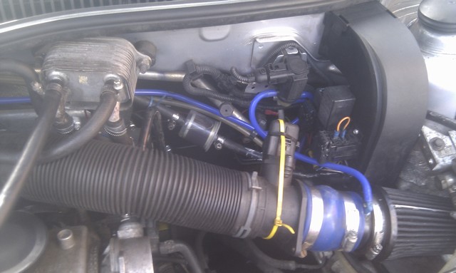

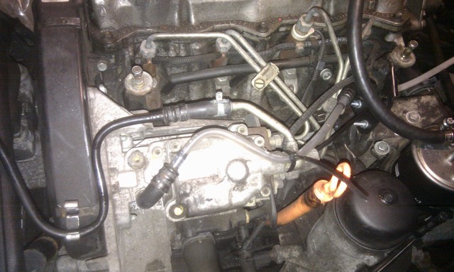

Next up was to reverse the inlet and diesel pump pipes. This pic shows the return pipe heading left
by unbolting the pipe and flipping it to the right it was heading where I needed it to (solenoids)
With all the pipe connected up I bunged the K&N on
I want to move this down the side of the battery at some point to be near the airflow but here is fine.
