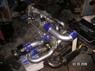

Engine details:EJ20T from an early JDM Impreza. Modifications to engine to fit in the Split engine bay :-
Shorter fatter Sump,
Custom manifold to re-locate turbo and improve ground clearance,
Throttle body turned 90deg,
New intake pipe work,
Custom exhaust with bell-mouth from turbo,
