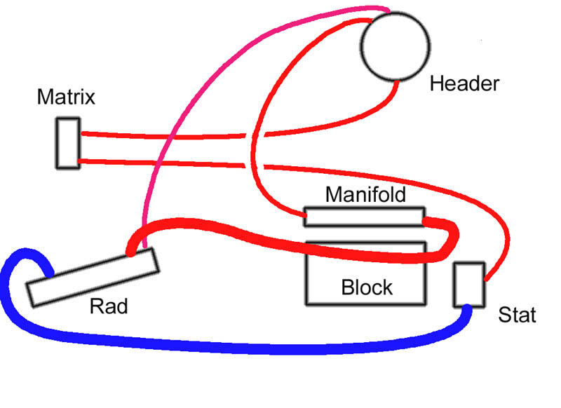

this is my first conversion,...that splitty bus thing is a schoolbus with 2 rooms on top.i live in it. Happy so i cut the apron out today and made a front scoop.im leaving the air pumper in till the last,till all the plumbing is done.the limo has to do a wedding next week.im going to mount the rad and then start running the plumbing.through all my research i havent learned what way the coolent flows?does it take water from the top or bottem,91 ej22.i asume it flows from the pump out the top of engine to top of rad then sucks from the bottem of rad when the thurmostat opens. sound good?the limo is a door longer then stock. hope that doesnt efect coolent flow. cool place,i like it here.

The water leaves the block from the top manifold, into the rad and then returns via the thermostat.
You do know you have to connect the two heater pipes up on the block?
Here's my setup:

PostPosted: Sat Mar 07, 2009 9:40 pm    Post subject: Reply with quote
15mm ID pipe for the heater cct. You can double it straight back to the 'stat if you want to.
I'll stress again that you need to do this.
SubaruBoxer on Aussie Veebubbers has a reversed manifold on his excellent Scooby bug.
http://forums.aussieveedubbers.com/viewtopic.php?tid=35720#pid526463
Jorgen just cut the manifold and used some Samco hose, be sure to create a "lip" to hold the hose.
The hot from the engine goes into the rad at the top, cool water comes out from the bottom of the rad (as shown above)
Cold water's denser than hot so you use this to your advantage.
