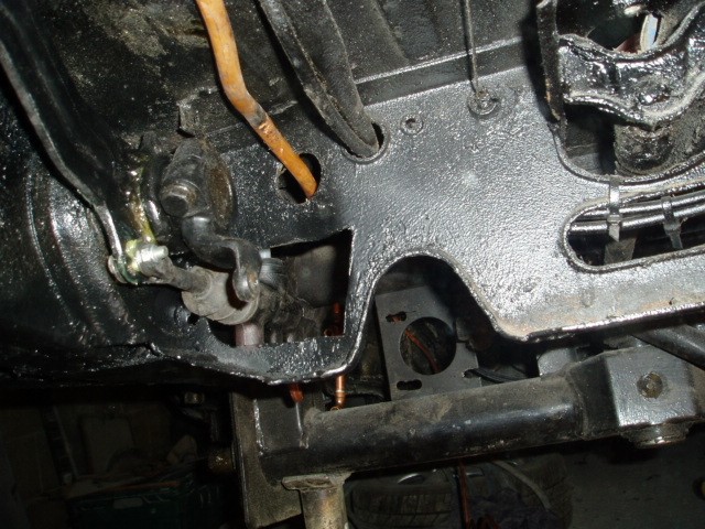

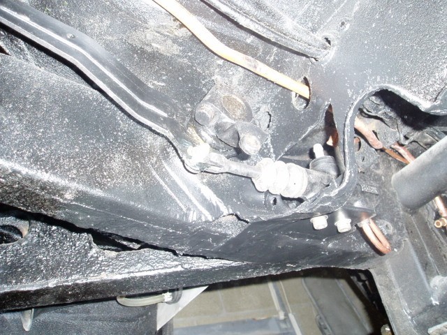

some pics.....if you look carefully - the pedal has a tab welded to the bottom which the clevis from an old clutch cable attaches to. the clevis is welded to a rod which is the pushrod to actuate the master cylinder mounted behind. Also included a gratuitous picture of my shiny gearbox showing the RJEs bits.

Posted: Mon Nov 10, 2008 6:05 pm Post subject: |
I see now, said the blind man......( took me a while )
what's that master cylinder from dude???
......... had a quick look on ebay and nothing looks worthy.....
cheers
...........might have to change my user name to 'the apprentice' _________________ '76 bay going superfly TDI |

richbaker78 Teacher of Padawans
Joined: 31 Jan 2006 Posts: 1298
Posted: Mon Nov 10, 2008 10:03 pm Post subject: |
for everyone elses benefit its t25.....but you can use most other M/C - i used t25 because they are cheap available and also matched the slave cylinder i was using.
