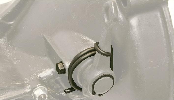

Should the clutch arm spring back after pushing/pulling it in one direction. .?
Mine just stays in whatever position I push/pull it to.
I lifted the rear wheels and changed gears.
I can get drive from the wheels with the clutch arm in both positions.
Does this mean I have a release bearing problem etc ?
Bear in mind all of these actions are being done at the gearbox side.
I've no clutch pedal installed yet.
splitbusvanatic
Joined: 08 Oct 2006
Posts: 330
Location: Co. Mayo, Ireland
PostPosted: Fri Jul 29, 2011 3:17 pm    Post subject: Reply with quote
Just to expand on the Clutch lever arm.
Do I need a spring inside the lever arm on the shaft. ?
Outside the box. But inside the shaft.
To return the lever arm to a state of clutch disengagement.
Or should it spring back on it's own. ?
Remember.
I've put on a post '76 bay clutch lever arm on the shaft coming out from side of the gearbox. All of this to do away with the hydraulic operated clutch.

you need a spring like it is mounted on the stock cable operated gearboxes in vw´s with lawn mower engines. iirc there exist two different springs as the shaft-size grew up a few mm in ´76.

Thanks For The Reply GratefulGerman
As I have Fitted Item 13 Above.
Do I need Item 12, or is it there on the gearbox already.?
And Is It Just a matter of pushing the spring on first, then push the lever/arm on afterwards..?

Ok So, Found A Great couple of Images in Just Campers website,
Couldn't have answered my question better really.
It's a Learning Process I Guess..
Cool
