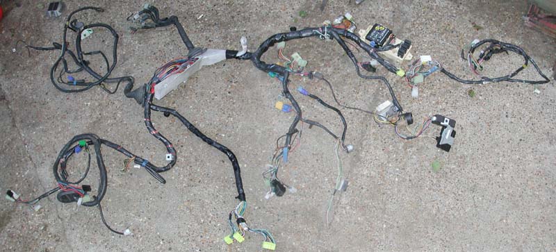

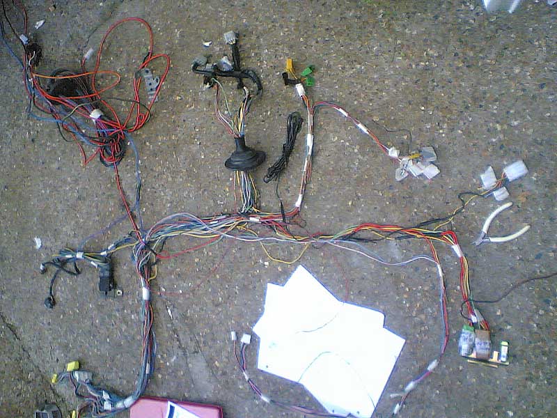

I did mine (98 EJ20 NA) myself. It was a pig as I couldn't find a wiring dia and buzzed out the ECU blocks.
Do you have the donor car? Makes life a lot easier but only if you tag every connector when you rip out the loom.
I ended up with 3 carrier bags of unused wires.
From this:
To this:
Then I wrapped it up nicely.
