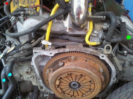

pic 1 radiators sit behind these so airflow has to come though radiator

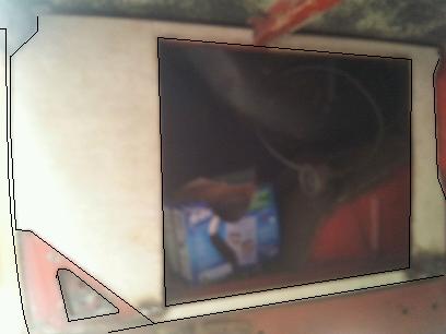

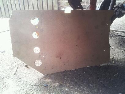

pic 2 template holes are for left and right.

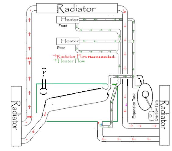

pic 3, need some help with coolant pipes, ones in blue are heater, green?
one with red not coolant?
pic 4 only intend to run rear heater and add front later, not a complete circuit .
