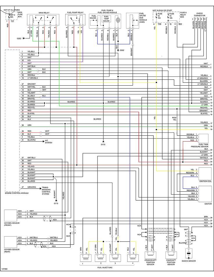

still working on the loom shortening the wires at the connectors.
i will post what i have of a diagram soon. _________________
