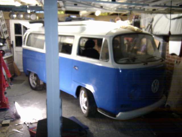

Finally got Round to uploading some pics of my slow progress.
First off T25 Washer install (Riches 3rd install and saving the best for last Grin)
Put hole in floor in a welded box type affair
from underneath
Weld couple of bolts to Y-piece of Chasis which is made to slot up the T25 Washers bottle
Also note the front heater installed and motorbike rad for charge cooler Grin
Screw on the lid jobs a good un
PostPosted: Thu Jun 02, 2011 11:16 pm    Post subject: Reply with quote
Whilst Rich was doing that I was cleaning up painting and putting the bits under the front arches back together Wink
Cleaned up and painted with some new beetle shox added
Early (drum) bay spindles on
Shiney new adapters on
On with the Porsche 944 S2 Hub
and disc
and the Porsche Big Blacks calipers (yes I need to paint them)
Just need to sort the brake pipes then paint calipers and job done Grin
PostPosted: Thu Jun 02, 2011 11:23 pm    Post subject: Reply with quote
Fitted heater box under cab floor which links up to the orig totem
Also Charge cooler rad fitted up the front, intention is to funnel some air to it some how
and the connect to the totem (which needs painting)

EPS installed and working
Totally amazing how light the steering is and nice and quiet, it has an adjustment knob which allow you to deassist to get some feel... all in all well chuffed with it.
I'll try and do a video of it in action.
