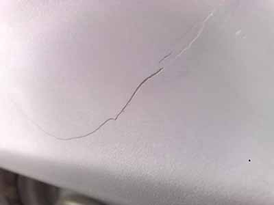

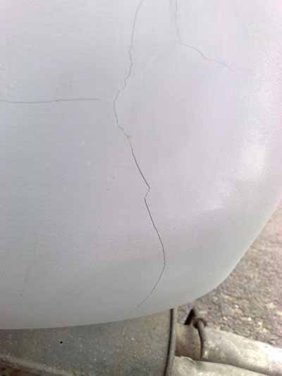

I've run into a problem, this is 2k high-build over barcoated areas
I sprayed it on Sunday & within an hour or so I noticed some "rips" forming. These were only 1" or so in length
I got home tonight (4 days after spraying) to see this:
Rear corner
NS rear arch
Any ideas as to why it happened & what the remedy is?

You did the painting outside, right? Was it a humid evening?
Humidity increases the stress (surface tension) of the paint when it's curing, paint will always shrink during the hardening and the humidity causes the paint to be brittle during the process. When the surface tension is higher than the mechanical bonding, it will crack.
Probably no problem with the paint. I think it was too cold and too wet outside. Try to respray, thinner layer on a warmer day. |

It would have been more of an "oh crap" moment if it had happened *after* I'd top-coated.
Cheers for the reply Sven. It was cold on Sunday & yes I did spray outside (no choice)
I think it's gonna be a sand it back, dust over with less hi-build or even 2k etch.
It really appears to have happened where I'd "spotted" areas first.
I'm just very surprised it's taken around 4 days. The initial splits happened within 1-2 hours and were around 1-2" in length. _________________ The advice you receive on here is worth the paper it's written on.

| 2K clear or paint takes long time to cure if it's not heated. Dry is not the same as cured. When running parts in 60 degrees Celsius they are cured in an hour, but they still "post harden" for a day or two. |

I just hope it's finished doing its thing.
I'll hit it with a hairdrier when I spray the patches.
It only seems to have happened on the curved sections of my panels, not the long, straight bits.  _________________ The advice you receive on here is worth the paper it's written on.

Sanded the problematic areas down (thanks T2 turbo & Sven)
Snotted on some 2 k etch prime and she's looking like she's good to go.

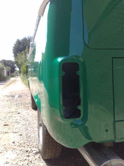

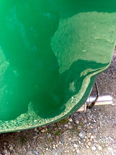

Well I sanded right back & etch primed, followed by high build
Splashed out on some Java Green, along with a new back box....
I've just finished replacing:
NS Front arch, b-post, sills, top hats, JPs, rear arch (inner & outer) & rear corner
My NS door and tailgate are worse for wear but they looked even worse with fresh paint all down the side so I quickly topcoated over the rust
No, I'm not going to post the runs!
Just gotta sort the back, front, roof...
Steffan, that's my workshop, welding bay & paint booth - the great outdoors _________________ The advice you receive on here is worth the paper it's written on.

that looks great! _________________ just do it! |

Java green is one of the nicest VW colours available IMO. Very nice.  |

Nice and shiney

Weheey, that was a little bit better than the last pictures.  |
