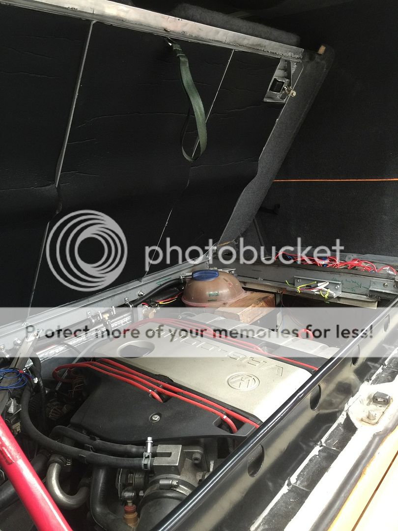

PostPosted: Thu Mar 16, 2017 12:14 am    Post subject: Reply with quote
Here's mine in a splitscreen before removing to fit an R32..
Very happy with how it performed.
