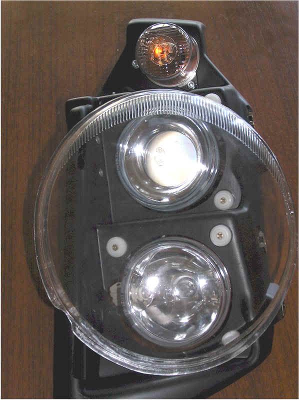

Righto, got some pictures for you all to wet your whistle.
I got two 2009 Audi bi xenon headlights (both LHD ), had to buy the bulbs and ballast separately. Think it's cost me in the region of £200+ so far but it's all Audi oem kit. The projectors are the valeo brand types.
I've only got to the dismantling stage buy it's all useful info regardless.

Progress....... with a massive thank you to my neighbour John:
There's no going back to the old H4 bulb now.
Smoked lens fitted here
Next in my list is to mount the projector to the bowl,
Finish my ingenious shrouds to cover the lens spacer,
Create a masterful rear cover to seal the unit together and mount the ballast,
Create a suitable wiring loom to power the ballast, operate the full beam shutter and also integrate a means to flash.
